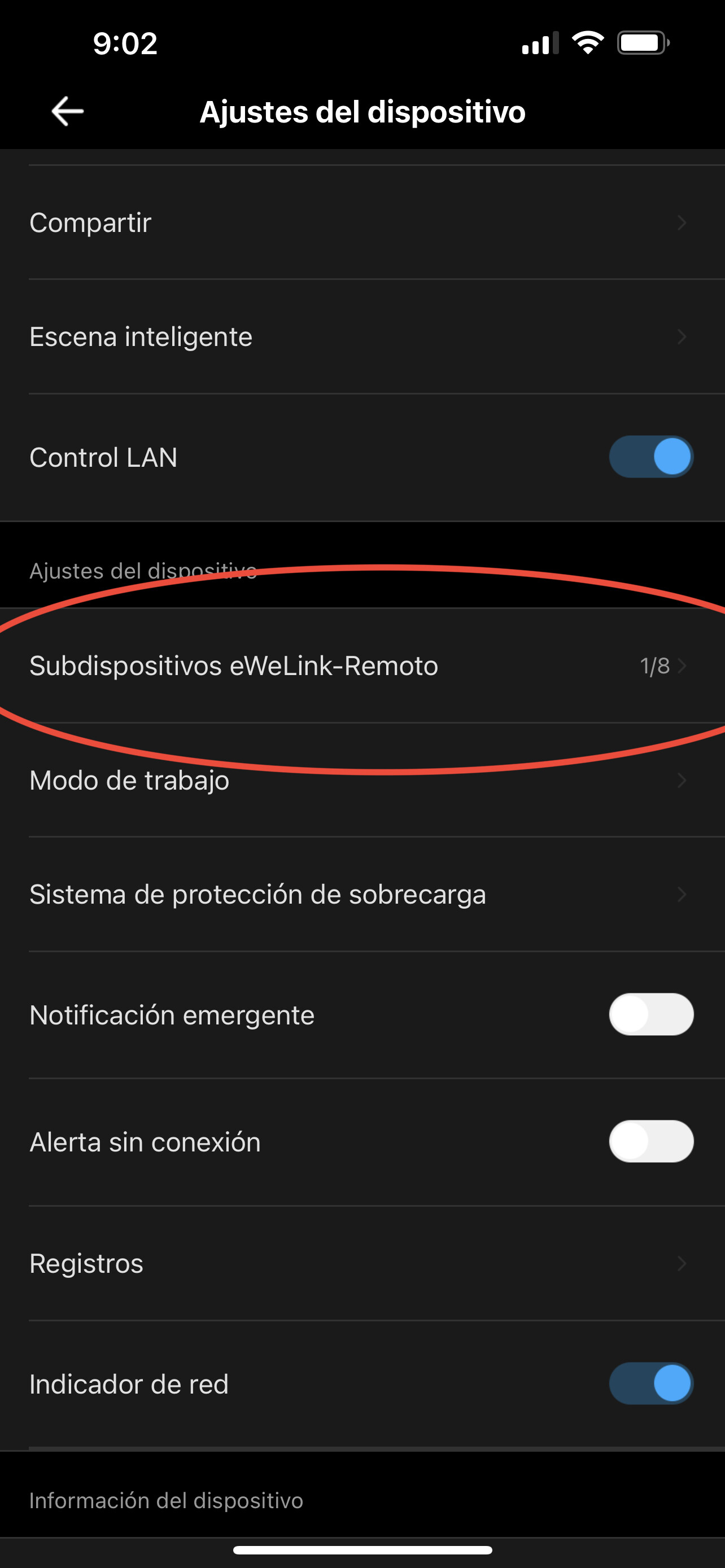

How do I add it?
There is no option to add ewelink remote devices or is the add zigbee option used?
When I add an a-mate2, the option appears under compatible devices as add sub-devices.
There is no such option here.

DualR3 photo

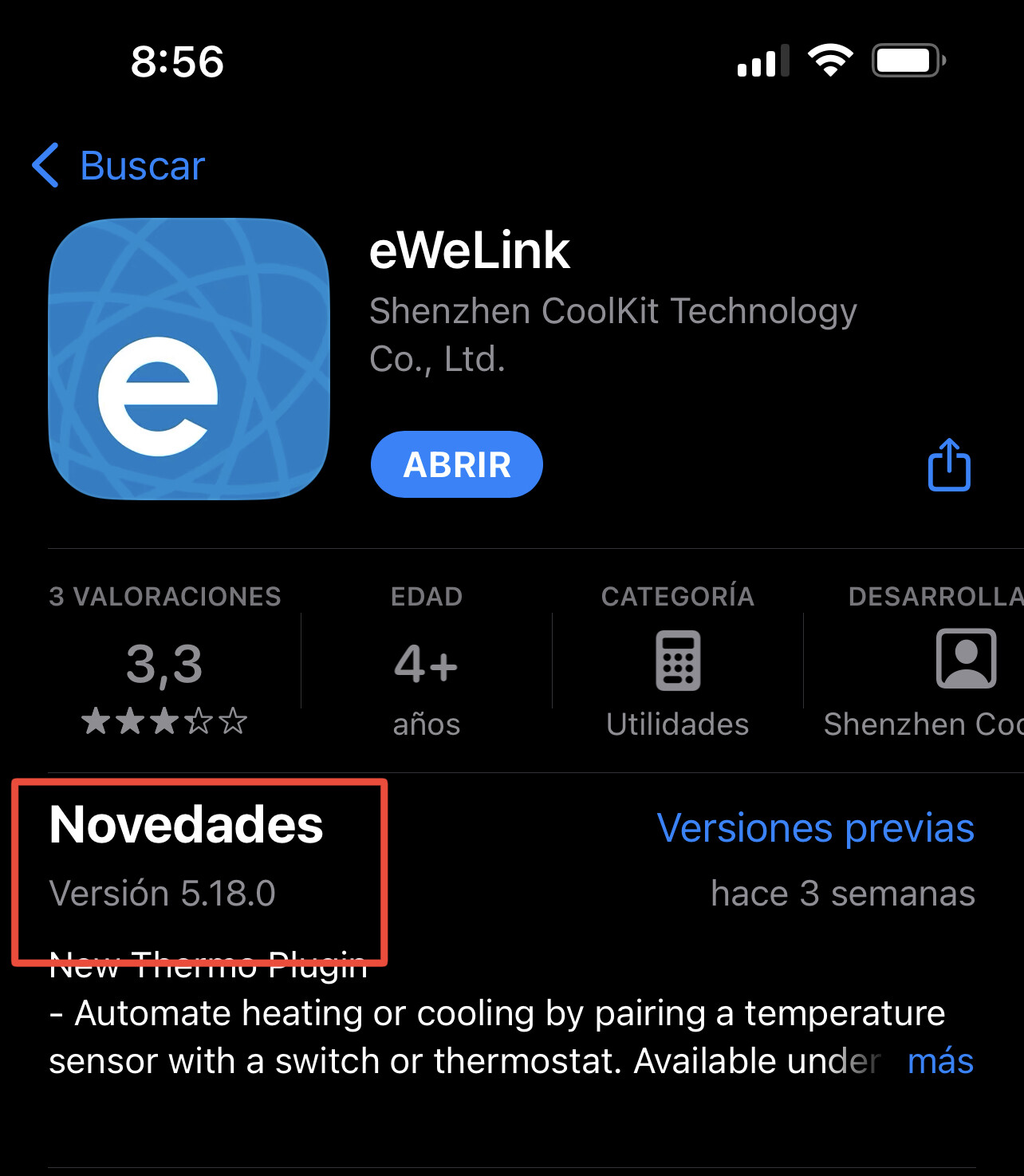

The ZBBRIDGE is up to date but on iOS the latest version is 5.18 and there is no new version available today.
Is there a problem?
Is it sent to apple?
Hello! The Android version is already available, and the iOS version is expected by the end of this month. Thanks for your patience.
