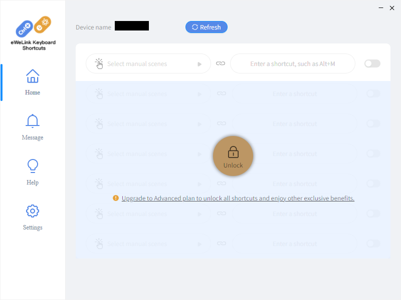

I’ve been having this problem, suddenly it stopped working, I’ve already uninstalled it and made a new configuration, but everything is the same

Thank you for providing the logs. We have identified the issue, and it seems that the failure might be caused by a significant time difference between your computer’s system time and our server’s time.
Could you please try syncing your computer’s system time? Here are the steps to do so:
  1. Open Date and Time Settings:
  • Right-click on the time in the bottom-right corner of your screen (in the system tray).
  • Click on “Adjust date/time” from the menu.
  1. Enable Time Sync:
  • In the Date & Time settings, make sure the “Set time automatically” option is turned on.
  • If it’s already on, the system will automatically sync the time with an internet time server.
  1. Manually Sync Time (Optional):
  • Scroll down and click on “Sync now” under “Synchronize your clock” to sync immediately.
Once you’ve calibrated your system time, please try to refresh the page.

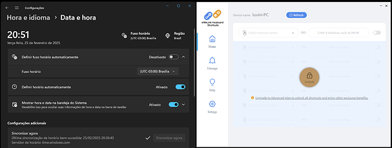

My date and time are correct
i think i fixed it, by changing timezone to UTC then back to my actual timezone, eWeLink Keyboard started working
