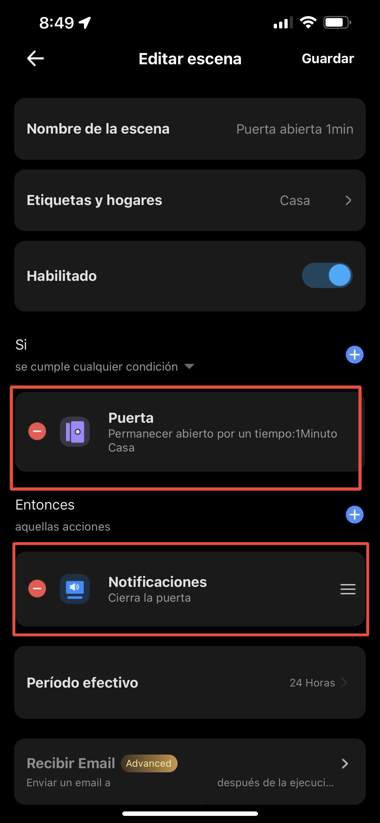

Hello I have created an automation, when the door sensor is open for 1 min send notification to the mobile but it does not arrive.
Does the same thing happen to you?
With the Xiaomi sensor I don’t have this problem, I get the “you’ve left the door behind” warning at the minute.
In ewelink I get the notification when I open and close the door.
But I don’t get the notification when it is still open for 1 minute.

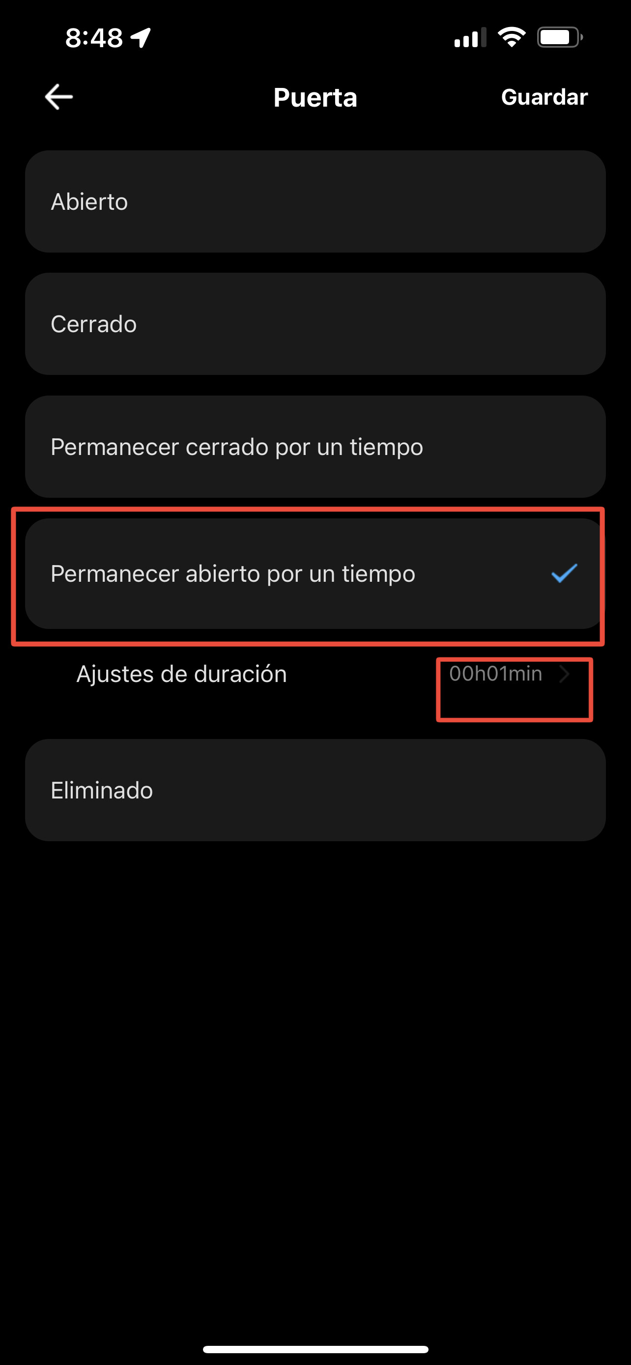

I have set the parameters correctly.
1 door open more than 1min
2 send notification “close the door”.
The automation is simple but it does not run and I have created another one with alarm to the ZBbrige-U and it does not sound either.
It only works if I close or open it but does not run if left open for 1 minute.
Thank you.

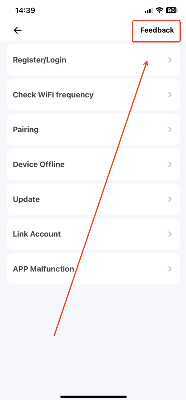

Hey, here’s a screenshot of where to submit a ticket in the app.
If your app looks different, just send me a screenshot.
Or DM me your web ticket number or eWeLink account — we’ll help you follow up and get this sorted.
I found it!
Thanks in the translation it has a different meaning, that’s why I never pressed it.

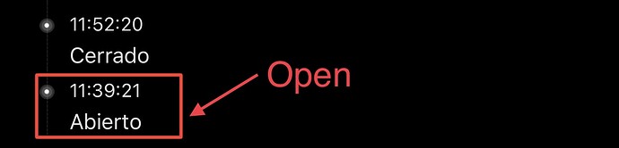

In order not to open and close the door of my house to do the tests, I used another sensor.

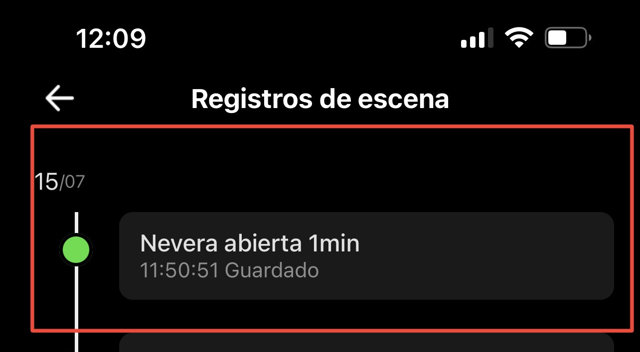

I have set the same scene and it has executed it after 11 minutes.
To know the exact time I have changed that it warns me when I open the sensor is an option within the sensor instant notification when opening and closing so I have a warning and I can make screenshots.

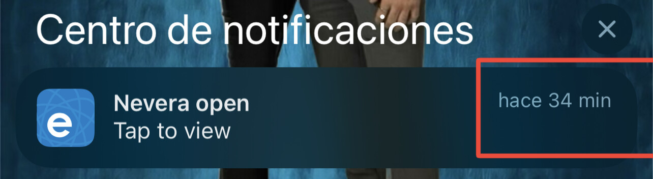

I have called it Nevera will be to put it on the fridge now I use Xiaomi for this and I want to remove it but I need these notifications in sonoff.
I opened it again and I got the notification “Nevera open” instantly.
But the scene has not yet been activated and it has been 34 minutes since the warning is the same scene before I did not have the notification option enabled and now if I’m going to try removing it to see if it affects.

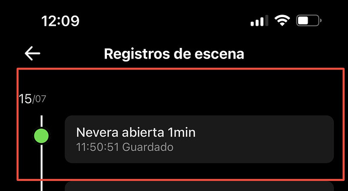

Sending history capture when the scene was executed with the test sensor has a random time.
More than 10 minutes.
I just did another test it takes more than 8 minutes I will wait to see what happens this time I have disabled the open and close notification.
