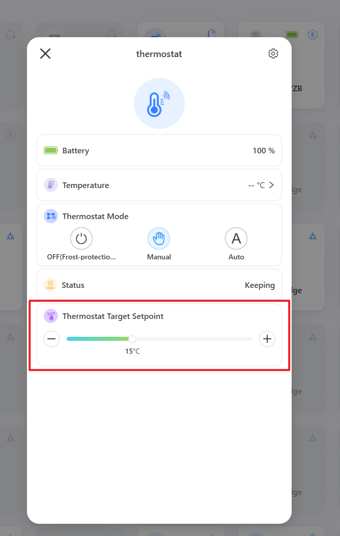

I’d like to create a thermostat to select a temperature, using some kind of slider or a field to enter a number. Then, with that value in Node-RED, I could control the heating system, turning it on or off.
I’m assuming you’ve already synchronized devices via the Open API and understand the end-to-end flow for syncing and controlling them.
Unfortunately, because thermostatic valves are relatively complex, the Node-RED plug-in does not support synchronizing this type of device; however, you can still control them through the Open API.

  1. Synchronize a simple thermostat via cURL
curl --location --request POST 'http://10.10.10.214/open-api/v2/rest/thirdparty/event' \

And you’ll see your device in iHost and the slider you needed.
  1. Create a Node-RED flow to handle requests

    Operate the slider; you should see the temperature changes arrive in Node-RED. Then you’re free to do anything you need with the temperature.
