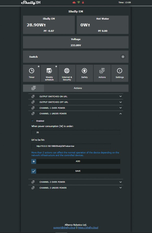

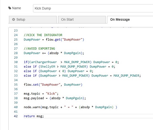

  • Stop solar export in low load situations, which does happen when the house is unoccupied
  • The 2 second update

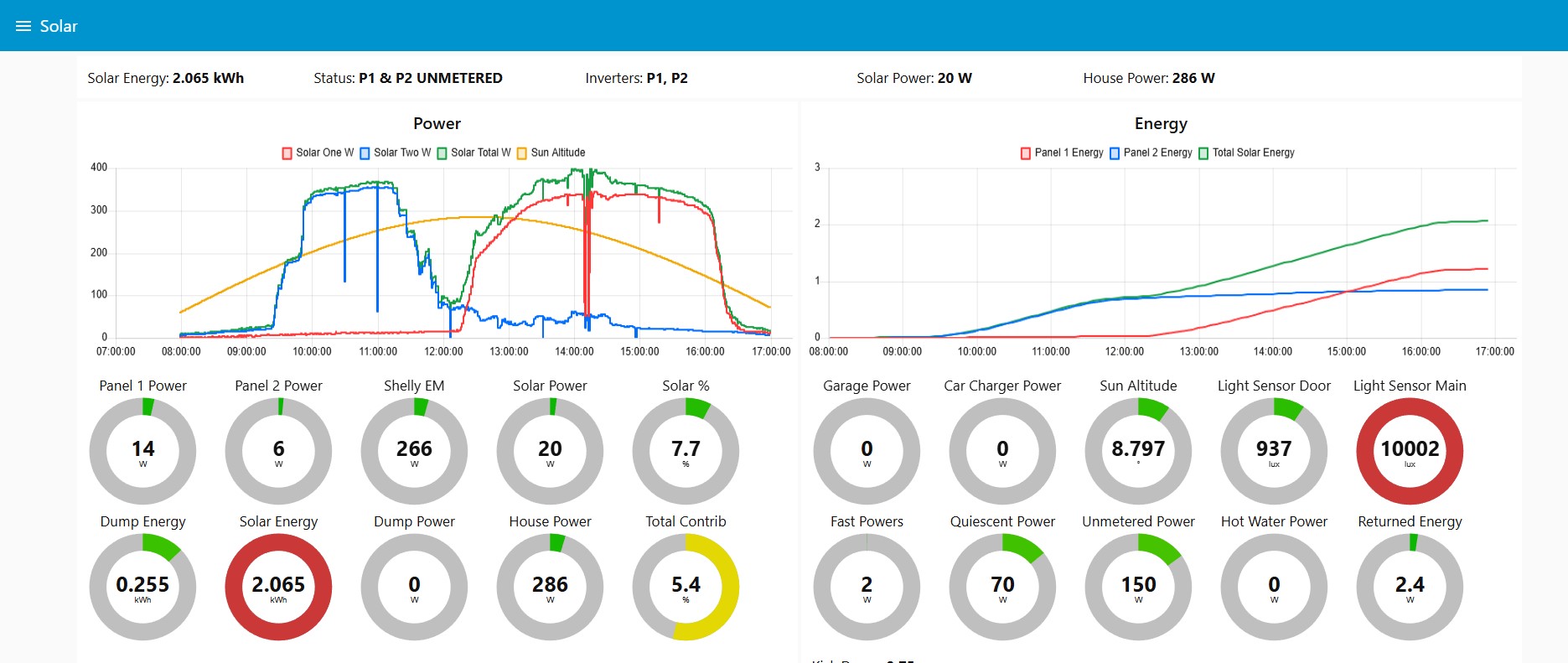

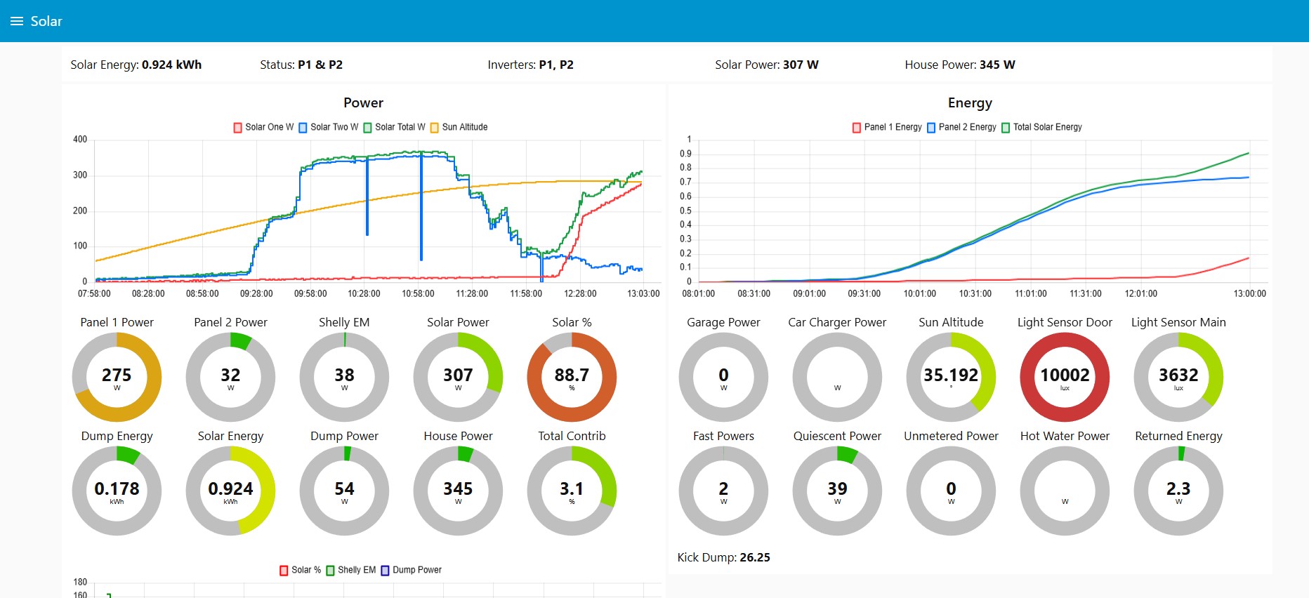

You can see in the above the dump load a $5 lamp regulates the load so I DON"T export hardly any power.
We produced 2.065kWh dumping 0.255kWh with a single panel generating 371 Watts peak so far today we have only exported 2.4 Watt out of 2.065kWh generated

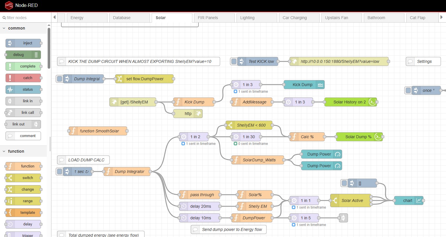

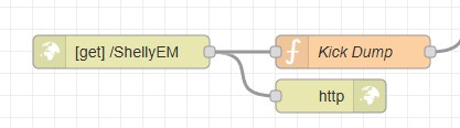

Not Matter, its using HTTP vis MakerAPI to handle inter hub communication
I’m using the node red plugins that leverage the MakerAPI so you have to be careful how fast and how many hits you make on the API to avoid errors.
