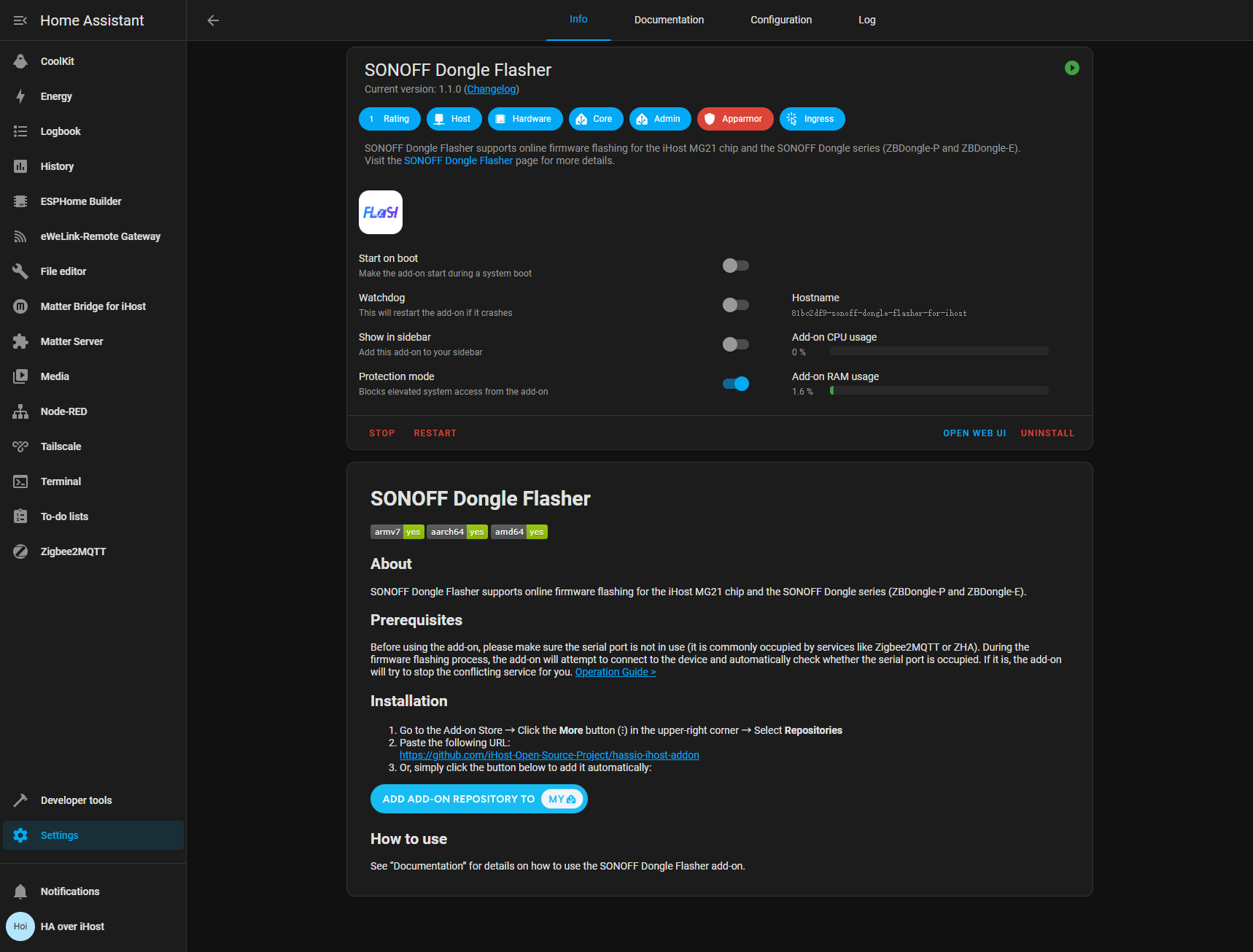

Hi @alyusuph We have just released SONOFF Dongle Flasher add-on v1.1.0 which is basically an HA add-on version of the Web tool SONOFF Dongle Flasher, but it allows you to manage ZBDongle’s firmware without unplug the ZBDongle.
The v1.1.0 add-on is available in armv7, aarch64, amd64 architecture, so you can use it not only on iHost, but also on other HAOS installations. It supports flashing Zigbee Coordinator, Thead, Multiprotocol, 3rd-party firmware onto SONOFF ZBDongle-E (Silicon Labs MG21 chip), and Zigbee Coordinator, 3rd-party firmware on to SONOFF ZBDongle-P (TI CC2652p chip).
Please take your time to try it out, and tell us how do you like it.

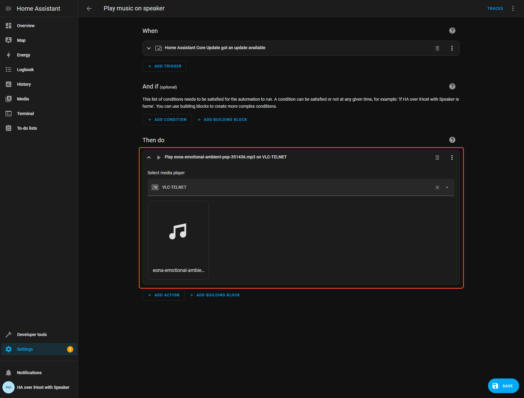

@tonivet @alyusuph The speaker of iHost will be supported in the next HA over iHost version which should be released next week.
You can then use VLC media player via Telnet to control the speaker manually or in Automations.

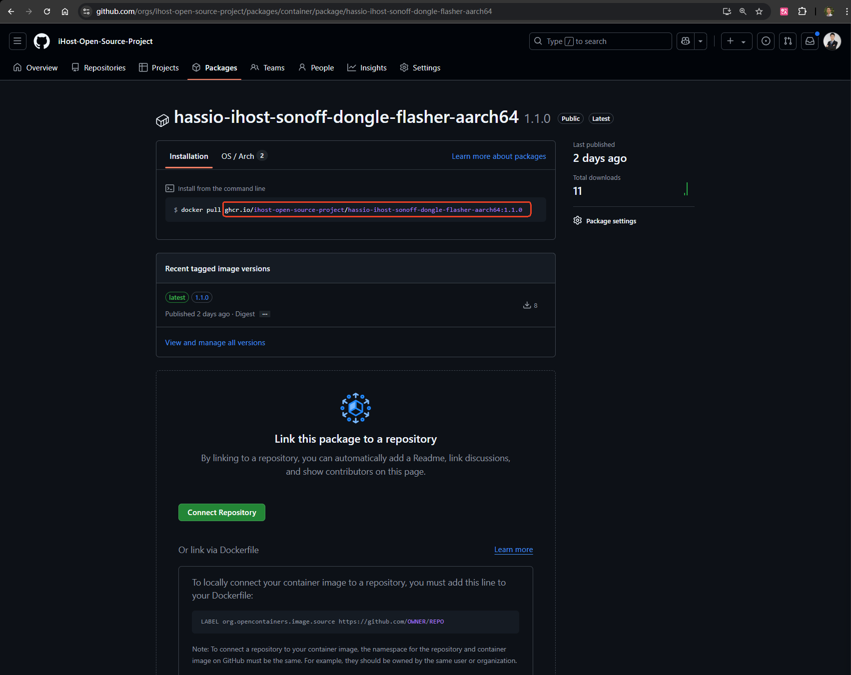

Hi @alyusuph thank you for trying out the SONOFF Dongle Flasher add-on.
The URL ghcr.io/ihost-open-source-project/hassio-ihost-sonoff-dongle-flasher-aarch64:1.1.0 itself is correct. You can verify it by visiting the URL in your browser.
Have you done any modification to Home Assistant of your Home Assistant Green device which could lead to change of default docker repository?
At the same time, we will try to update SONOFF Dongle Flasher on HA Green to reproduce the issue.

Hi, we have done an internal test and also discussed about the issue. We believe this is a bug related to HA itself.
The SoC of HA Green is RK3566, an 64-bit aarch64 SoC. SONOFF Dongle Flasher add-on before version v1.1.0 is only available in 32-bit armhf architecture. In version v1.1.0 SONOFF Dongle Flasher add-on is also available in aarch64 and amd64 architecture. So, whether an update for SONOFF Dongle Flasher v1.0.2 (32-bit) on HA Green should be v1.1.0 of 32-bit armhf or v1.1.0 of 64-bit aarch64, HA Green chose v1.1.0 of 64-bit aarch64, but it messed up.
A temporary solution to this issue, could be that uninstall the old v1.0.2 version (32-bit) first, and then install the latest v1.1.0 version (64-bit). Please let me know if it solves the issue for you.

I was able to install the updates successfully withoujt ejecting the Dongle. The only problem.is that when I tried torun the process again, after updating, the firmware, with the intention of checking the updated firmwareversion, i lost ZHA device onnections. I was only able to restore ZHA with a backup..
Using SONOFF Dongle Flasher Add-on to manage MG21 chip firmware will stop ZHA and Z2M from working because Dongle Flasher Add-on will take over the UART interface of MG21.
After updating firmware, you should be able to use ZHA by restarting Home Assistant Core, or to use Z2M by restarting Z2M add-on.
If you met issue after updating firmware, it’s most likely caused by imcompatible version between ZHA/Z2M and the firmware. For example, if you update MG21 firmware to Zigbee Coordinator 7.4.x/8.0.x, you will need to change Z2M driver from ezsp to ember.

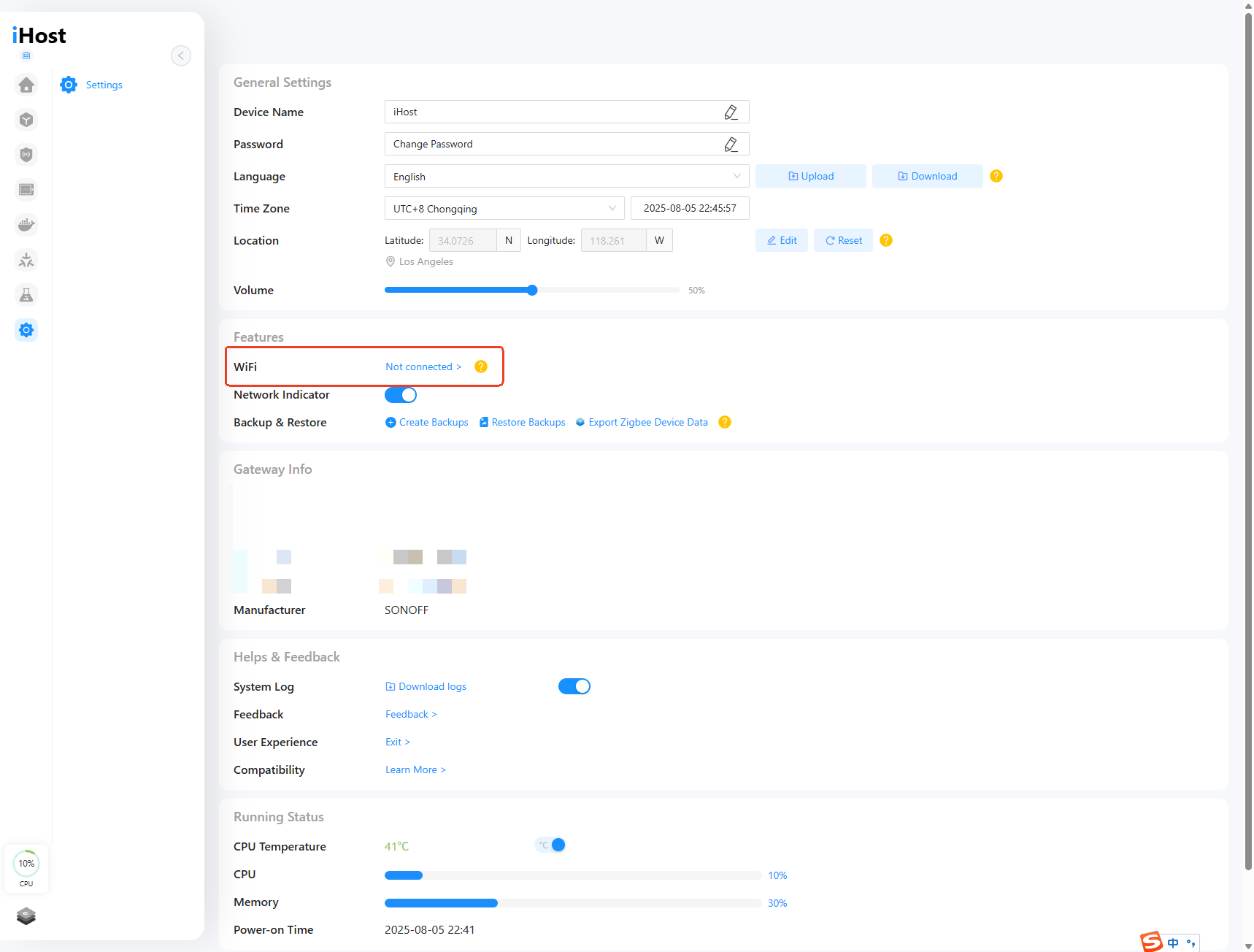

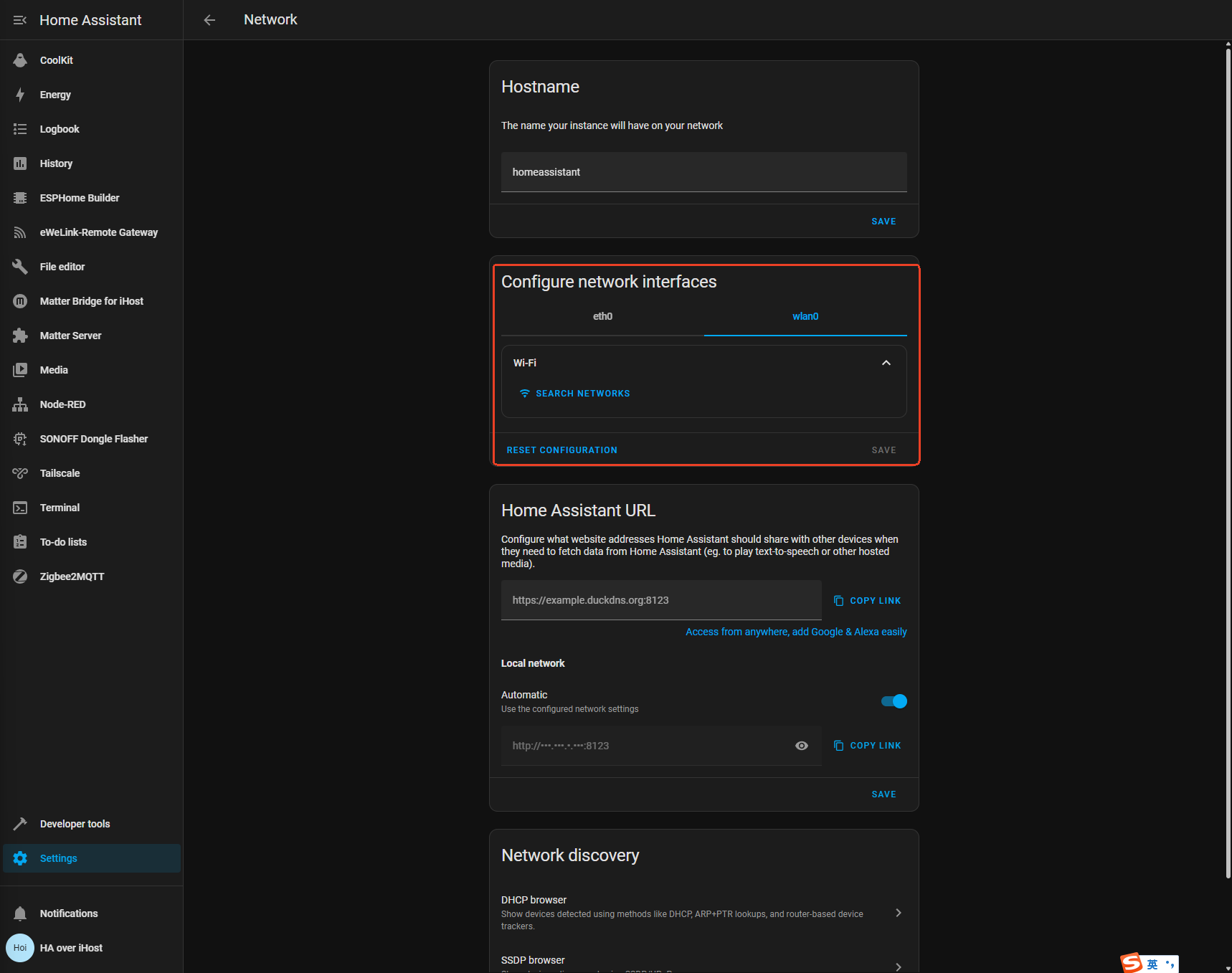

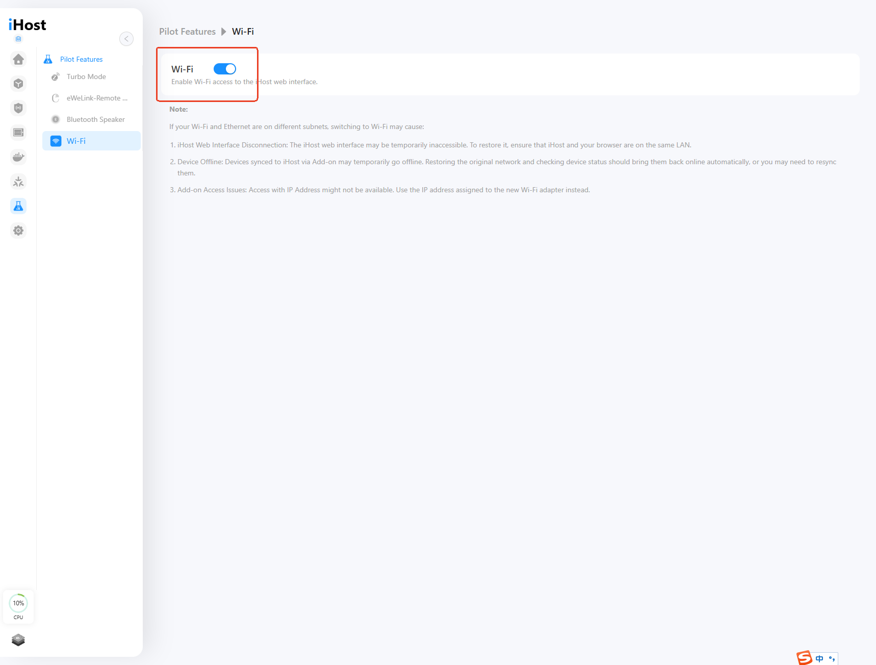

Hi, in instruction of using HA you explained that wifi can be also used for connection. On my ihost HA instalation there is no wlan recognised. Did anyone suceedd to use wifi instead of lan.
Hi, thank you for trying out HA over iHost.
If you don’t see wlan0 on page Settings -> System -> Network -> Configure network interfaces, then you can verify whether the Wi-Fi adapter is broken by:
  1. Boot into eWeLink CUBE OS (the internal eMMC, not the HA on the TF card).
  2. In the Web interface of eWeLink CUBE OS, goto page Pilot Features -> Wi-Fi
  3. Enable Wi-Fi
  4. Goto page Settings, you should see WiFi: Not connected > under Features. Click on Not connected > link, you will see Wi-Fi SSIDs detected by CUBE OS.
If the Wi-Fi adapter works on eWeLink CUBE OS, then it should also work on HA over iHost. If the Wi-Fi adapter doesn’t work on eWeLink CUBE OS, then it probably is broken. But you can still post the errors you encountered so we may diagnose it.
