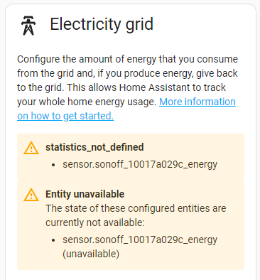

I have bought multiple sonoff devices for the purpose of power/energy monitoring that can be access and displayed at home assistant energy dashboard. So far only the DualR3 are working smoothly… my POW elite devices both 16A and 20A are not working and showing up at home assistant energy dashboard. Please see below for the screenshot of the error when adding the devices to be displayed at energy dashboard. Can some help me guide how to fix this error? Thank you in advance.
@yitie @StephenJ I’m tempted to do this (⚡SONOFF POW Elite Tasmota Firmware - YouTube) but i think that’s not the recommended way to do it. I believe a firmware update from you guys will be the better solution for this. Hope you consider. Thank you.

Hi there, at present eWeLink doesn’t support adding POW Elite into the HA energy dashboard.
No worries, HA is great but I have to say it’s not convince for everyone, especially firmware flash needed.
Maybe we’ll go deep to see how to bring the pow feature of POW series devices to HA later.
Ok. Thank you!
Ok. Hope you include this on your future updates. Thank you!
