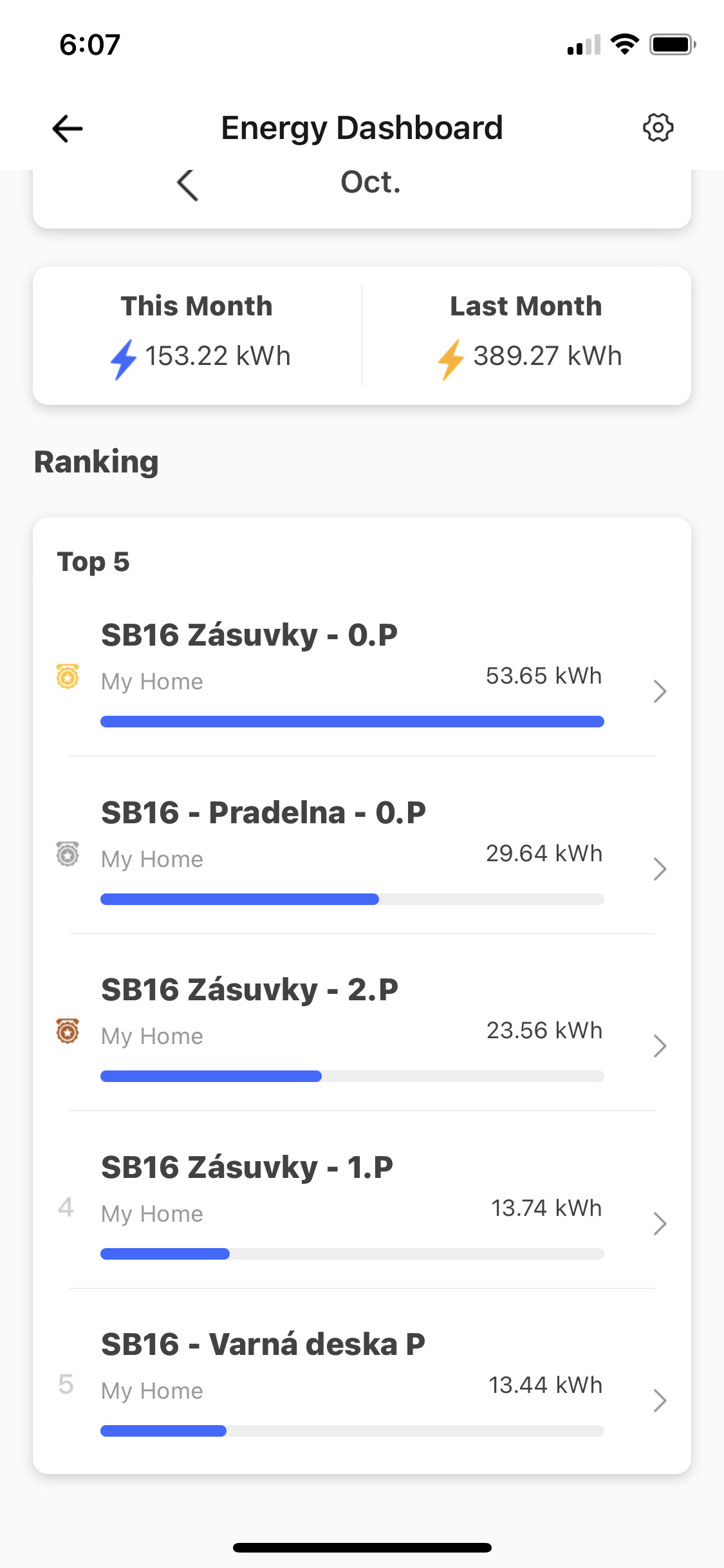

Hi, today my dashboard got updated - first time since October 1st, however data are inaccurate (~ 50% of real consumption) while data on individual devices are OK. I have iOS 15.7 and eWelink version 4.26.1. Seems still not fully fixed.
Hi there, would you please provide some screenshots for our further check?
Hi, adding by example: dashboard and daily consumption October 13 - 7.5kWh, October 14 - 2kWh, next list of all paired devices and by example just SB16 Zasuvky - 0P October 13 - 4.22kWh, October 14 4.25 and just this one device 63.49kWh in October. As I mentioned - all installed devices record consumption precisely and dashboard pulls data wrongly.
