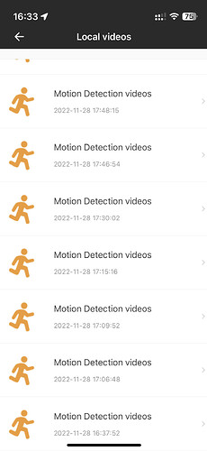

thank u for your reply
im uploading 3 pic the first 2 are the the first and last recording the 3rd pic is showing the status of my card
best regards
george
Hey there, thanks for the screenshots. We involved Sonoff team to locate this issue. We’ll get back to you later. Thanks for your patience.
