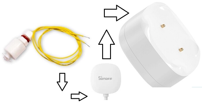

To check whether the water level reaches a specific point, I simply use a float sensor attached to the cable connector and a Sonoff 05P sensor.
Of course, this only gives a zero-one indication per point and not a 1L, 5L, 10L scale of how much the tank is filling up.

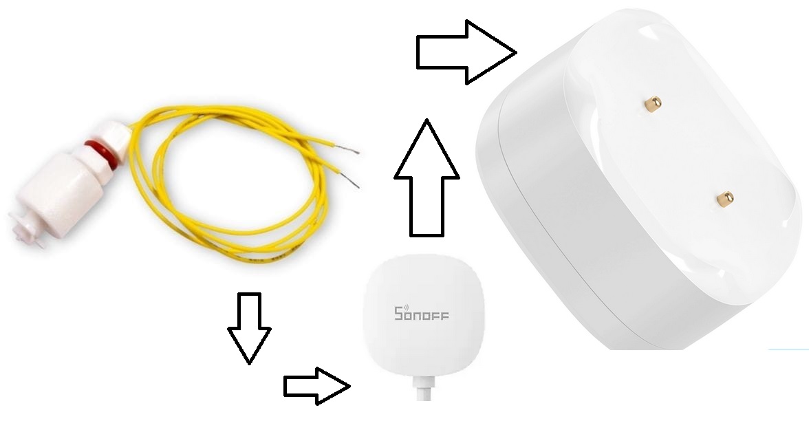

When the water level in the tank is very low, I use a float switch inside the tank to prevent the submersible pump (which operates on 230V AC) from activating.
The float switch disconnects a SONOFF MINIR4 device, which powers the submersible pump. This prevents the pump from running without a load.

I have a similar solution. It monitors low water levels in the tank to shut off the water pump so it doesn’t run dry.
My second solution is based on two 05P units. One monitors low water levels to protect the pump, and the other monitors high water levels to prevent the tank from overflowing.

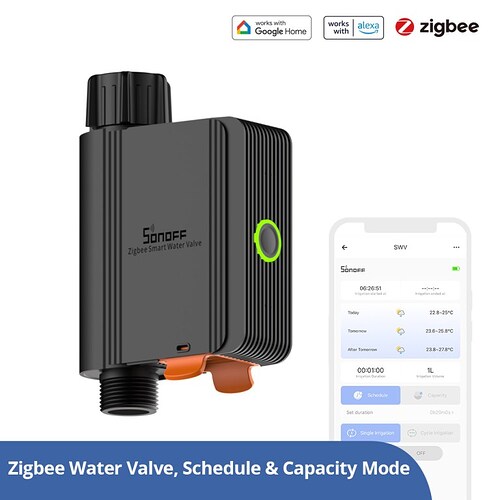

Theoretically, the SONOFF Zigbee Smart Water Valve is supposed to have the ability to monitor how much water has flowed, but I don’t have it, so it’s hard for me to say.

If you don’t need to monitor the current water level and just want to know when the water is reaching a certain point, a single 05P will suffice, provided you can permanently install the cable into the tank.
In this case, you would use heat shrinkable insulation with adhesive on the entire cable, leaving only the end with the USB connector (which will touch the water) uncovered. This way, you still have the same functionality of the 05P, but without the need to insert it into the tank, and just attach the cable once.
