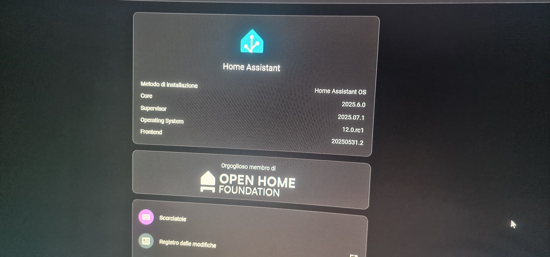

Hi @ReSeCa , the log you uploaded shows that you are not using the Home Assistant OS image provided by iHost Open Source Project, but the HAOS image from darkxst.
The Home Assistant OS version is 12.0, right? Can you please take a screenshot of the web page at Settings -> About.
Yes, you are using Home Assistant OS for iHost from darkxst, not us.
Sadly, breaking the ethernet chip is a known issue of darkxst’s HAOS image for iHost. We can’t do anything about it :frowning:
Why did you use the HAOS image from darkxst, not the one from iHost Open Source Project?
