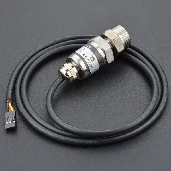

lol, the pump actually has an inline pressure monitoring device, but it’s not calibrated right and lets the pump run for way too long before it turns it off, which caused a few damaged pipes and one burst water heater. You can say I don’t have access to the pump, so I can only work from inside my apartment. Initially, I wanted to use a water pressure sensor like this, but I couldn’t find it anywhere locally, and its price is kinda ridiculous.
