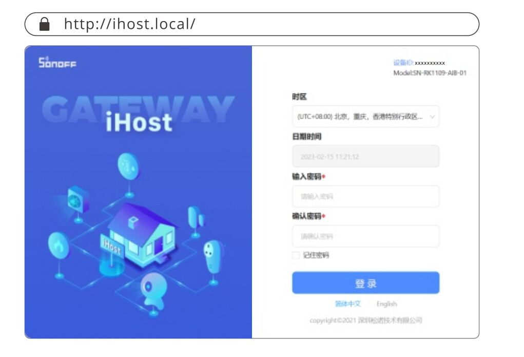

sonoff.tech/wp-content/uploads/2023/08/说明书-iHost-V1.0.pdf
This is from official Sonoff user manual.
So… login screen provide 2 informations. Device ID and Model name.
Unfortunately my iHost is showing only Device ID

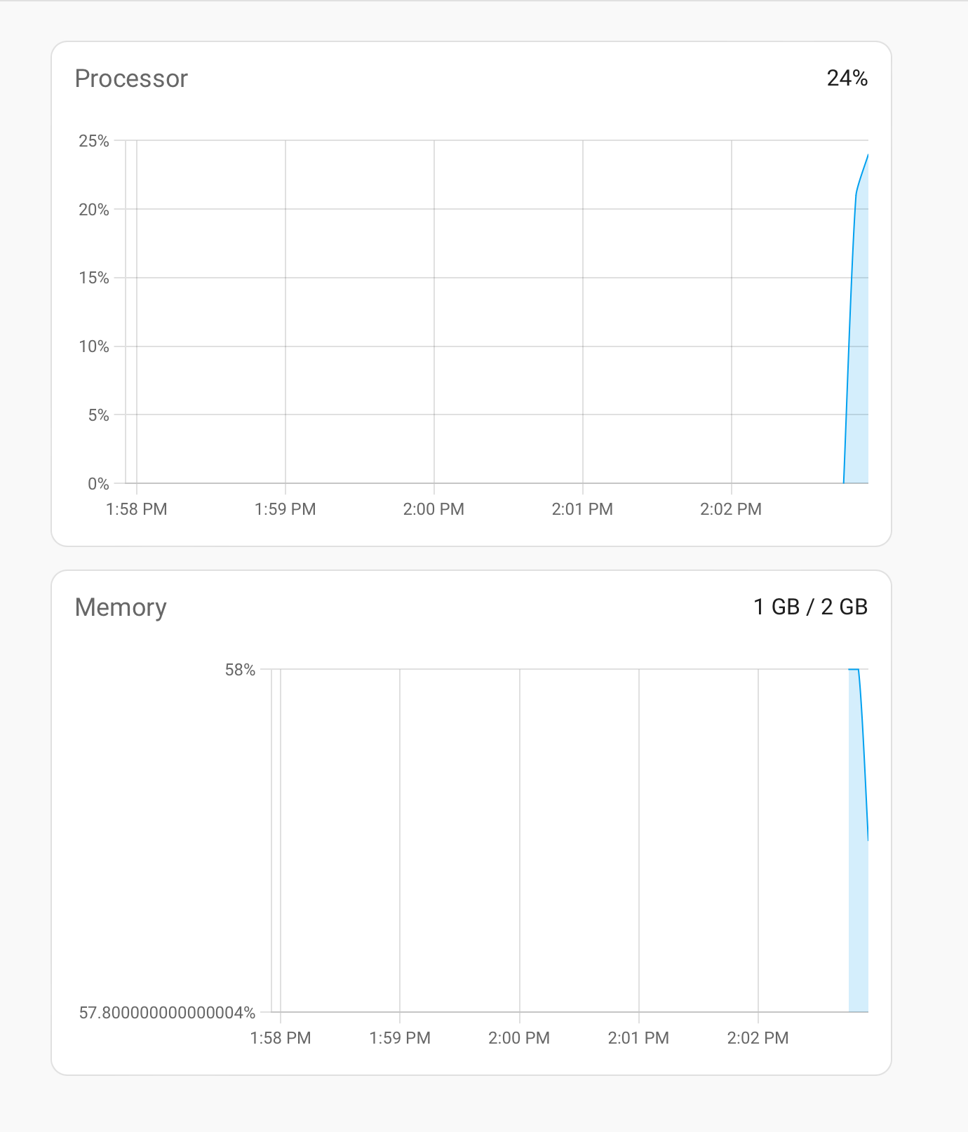

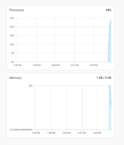

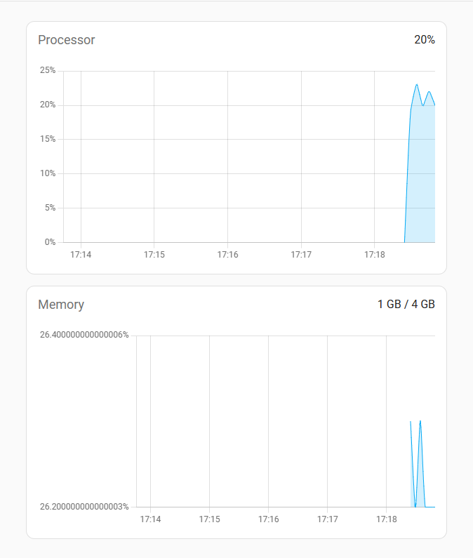

You can check this via some docker apps if they provide a WebUI. For example HA docker version will display RAM in the hardware tab
Thank you… I will try it next week.
Could you please explain this solution bit more?
What exactly do I have to install… and then where to check the RAM in hardware tab?
Click the ‘Add Add-on’ button in the Docker tab, then paste ‘homeassistant/home-assistant’ into the search bar. Choose the ‘host’ option when launching the container and head over to the onboarding page (typically ihost.local:8123) to complete the setup.
Next, navigate to home assistant’s (HA) settings page to check your hardware. Here, you’ll be able to see the amount of RAM your device has.
Sure, it might seem like a lot just to verify your device’s RAM, but it does the job.
Thank you for help.
