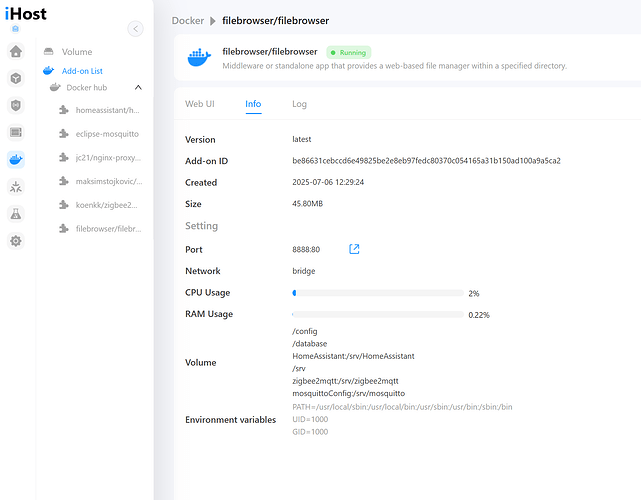

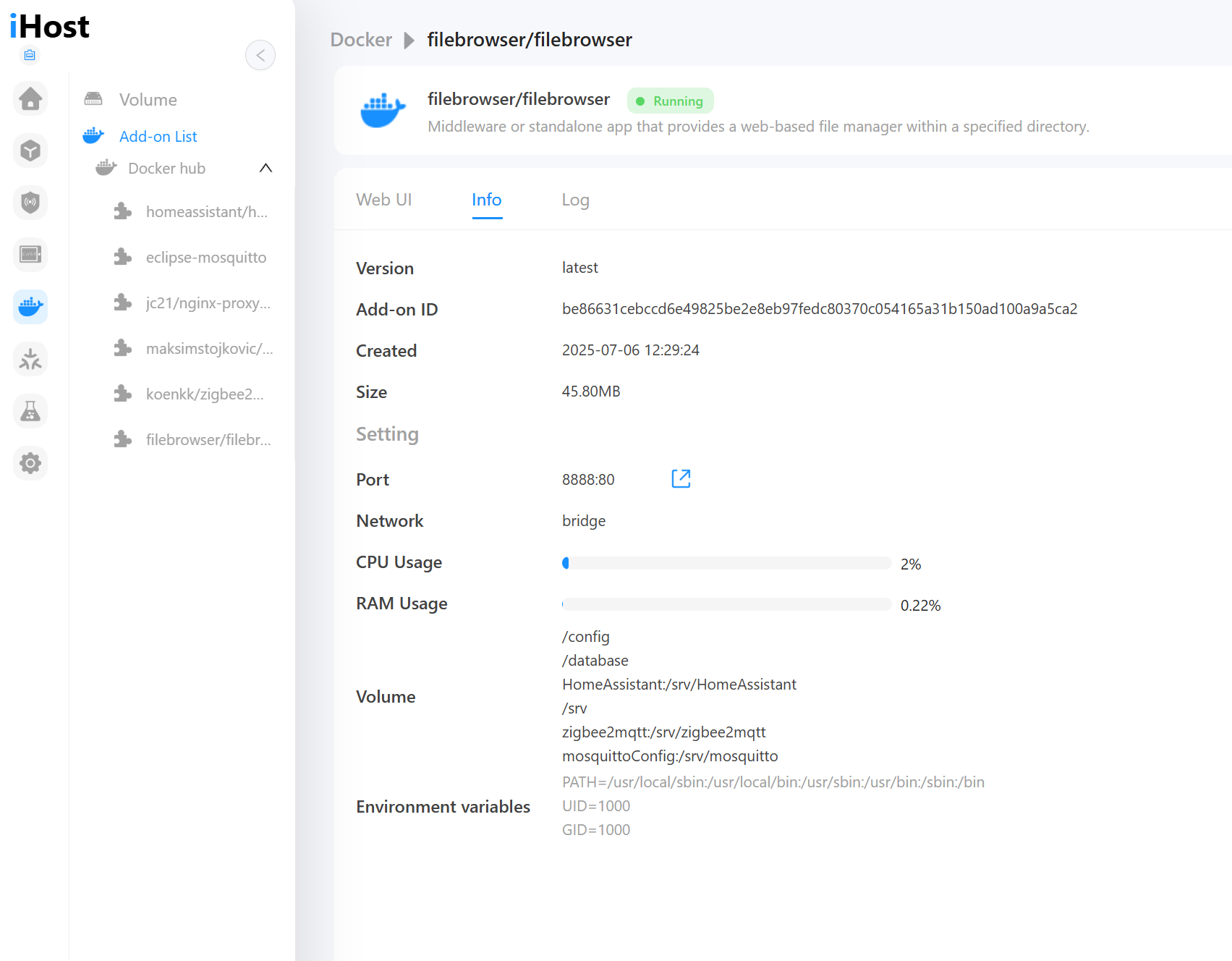

Since a few days I have problems with the filebrowser.
After an upgrade, both the filebrowser to its latest version and ihost to 2.5.2
I can’t create or edit files on the volumes I have mounted.
I browse through the volumes, ready them and it all works correctly, but if I try to create a file, directory or edit an existing one, it gives me a permissions error: permission denied
I don’t know if anything has changed in the way ihost mounts the volumes or permissions and some extra variable with UID, GID, etc. should be put in order to correct this problem.

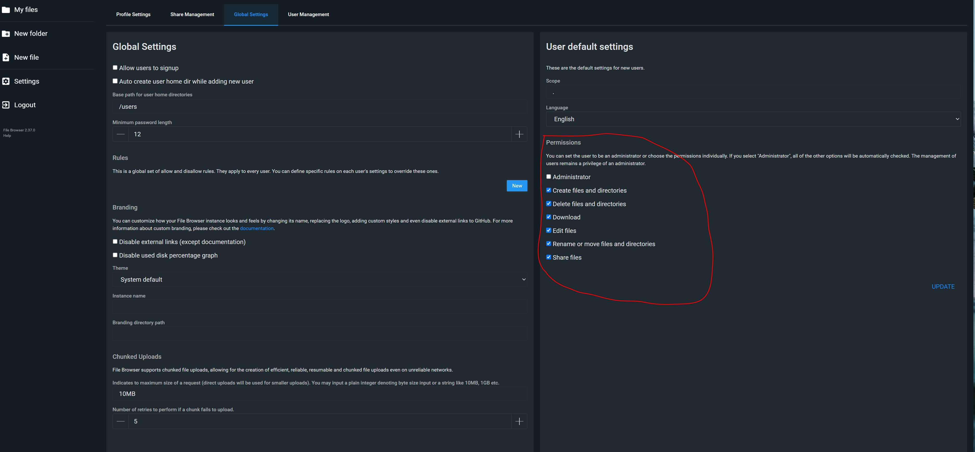

Good afternoon! Try adding the “auth.method=noauth” parameter when starting the file browser.

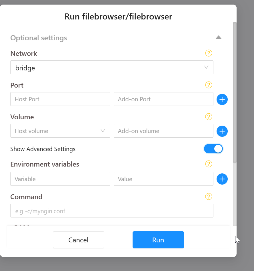

Yes, but it doesn’t let me edit the gray shaded area you indicate, in order to add it, the ihost options are these:
once I fill it up, it appears:
as I can edit those gray values ​​in order to add the auth.method=noauth

Unfortunately, I no longer remember which fields I wrote the application launch parameters into. Try two options: 1) specify the value “auth.method” in the “Variable” field, and “noauth” in the “Value” field; 2) write the parameter “auth.method=noauth” in the “Command” field.

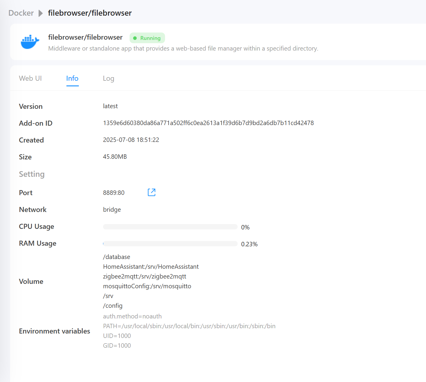

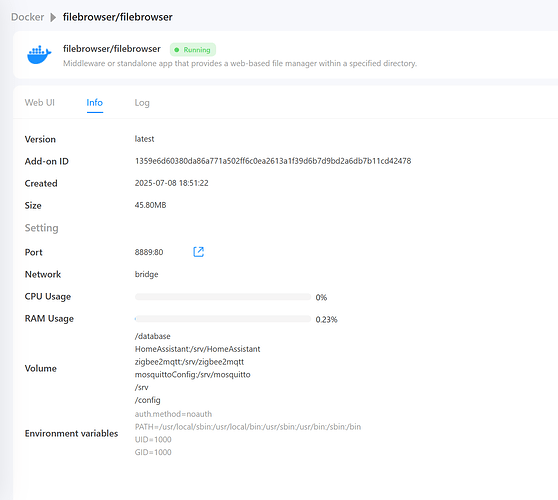

I have included the noauth , and verified that it appears, but it continues an erroneous operation without permissions:
I am trying to create a test directory:
2025-07-10T08:33:43.652922369Z 2025/07/10 08:33:43 /HomeAssistant/test: 403 192.168.68.109 unlinked /srv/HomeAssistant/test: permission denied
2025-07-10T08:33:52.729875741Z 2025/07/10 08:33:52 /HomeAssistant/test/: 500 192.168.68.109 mkdir /srv/HomeAssistant/test: not a directory

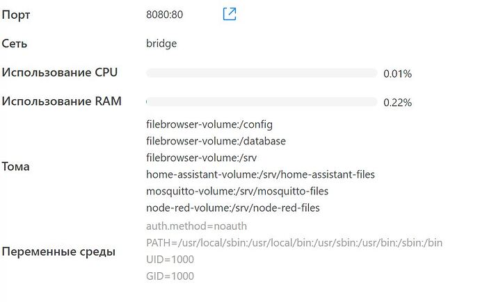

Also, try installing file browser not in the root, but in your volume.
For example, like mine:
filebrowser-volume:/config
filebrowser-volume:/database
filebrowser-volume:/srv

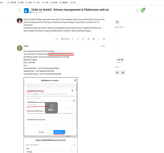

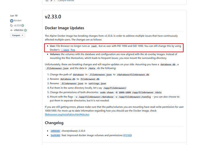

In version 2.33.0 of Filebrowser, the default running permissions were changed. Previously, Filebrowser ran with ROOT privileges, allowing read/write access to files. However, with the updated permissions, it no longer has the ability to modify files.
A helpful user has created a Filebrowser plugin that grants ROOT privileges. You can find it here: .【Add-on Guide】Volume management & Filebrowser add-on - #65 by john.e.dixon
In future versions, we will add an option to adjust the running permissions for add-ons to resolve this issue
The plugin belongs to @el404 !
