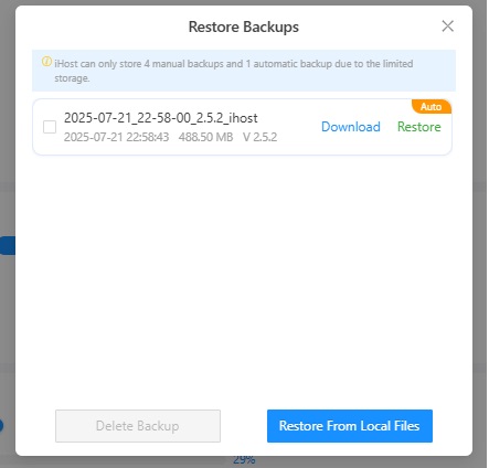

I just updated to eWeLink CUBE Version 2.5.1, When I try to make a backup I get this message: Insufficient storage, please delete old backups from the list. I have deleted all previous backups and still get the same message!?

Yeah those basic things of course i have already tried, was no problems before this last update to take backups.
I had 4 backups that I deleted and still can’t make one new!?

The eMMC memory only has 1.5 GB available for backup.
