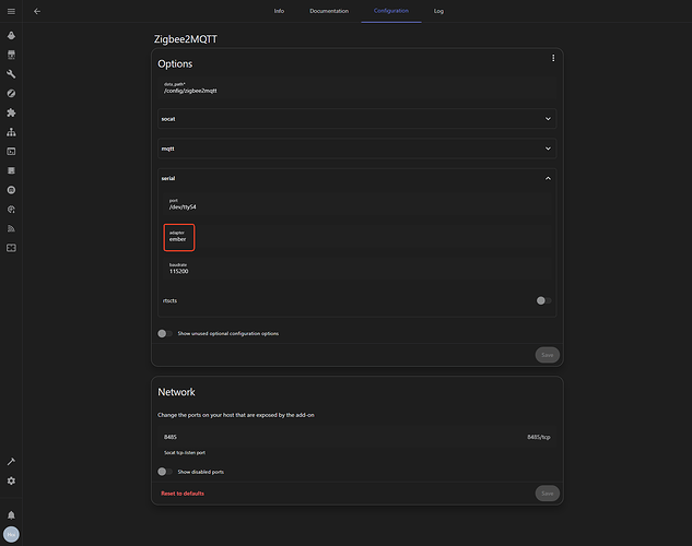

And one more question: do I need to upgrade IHost zigbee module firmware to some higher version from default installed in Ihost?
It’s better to upgrade the firmware of the built-in MG21 chip to v8.0.2. After you’ve done that, you will need to use ember instead of ezsp for the Zigbee2MQTT adapter setting.
