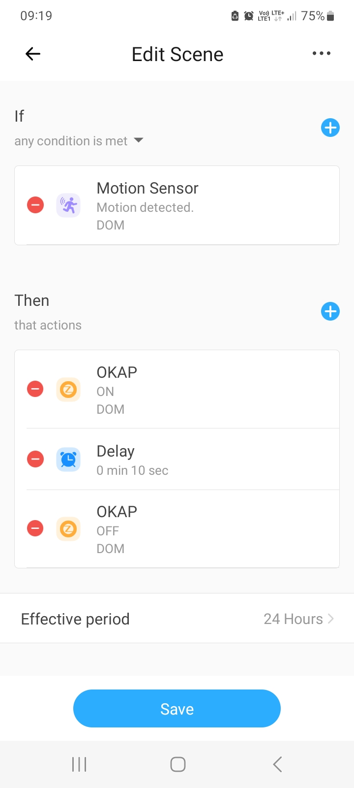

Hello.
You can fix auto scene in LAN mode added to nspanel pro.
Because in LAN mode it does not work properly.
The cloud scene works fine.
(The scene should look like this :
motion detected.
turn on the device,
wait 10 seconds,
turn off the device.)
and in LAN mode npanel pro works like this:
motion detected,
wait 10 seconds,
turns on and then turns off the device.
There is no information in the scene log that a Scene was performed.
