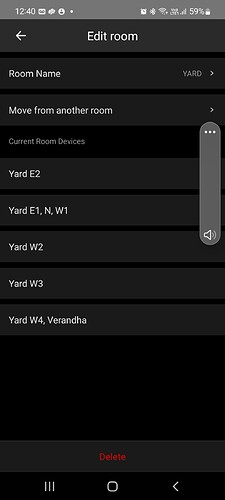

Thanks a lot for your quick reply, I have add room text but with the last ios version I cant see delete, it is my issue, could you send me a picture ?
I am using Android! However, I will try and send you a picture.
I dont know how to send a screenshot. Hope this works.
Thanks a lot
To delete a room in iHost:
  1. Move all devices out of the target room first
  2. Go to the room and you will see the EDIT symbol near the name. Edit the name.
  3. The interface shows existing rooms and allows editing
  4. Change the room name (triggers the save/delete buttons to appear)
  5. Delete button becomes available at bottom of page
  6. Confirm deletion
