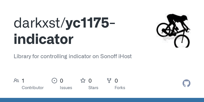

Here is a library for the yc1175. This will form the basis of upcoming custom integration for Home Assistant, however might also be useful for folks using the plain linux distro.
pip install yc1175-indicator
# main rgb indicator, blue flashing
indicator-cli 4 --effect 2 --rgb 0 0 255
