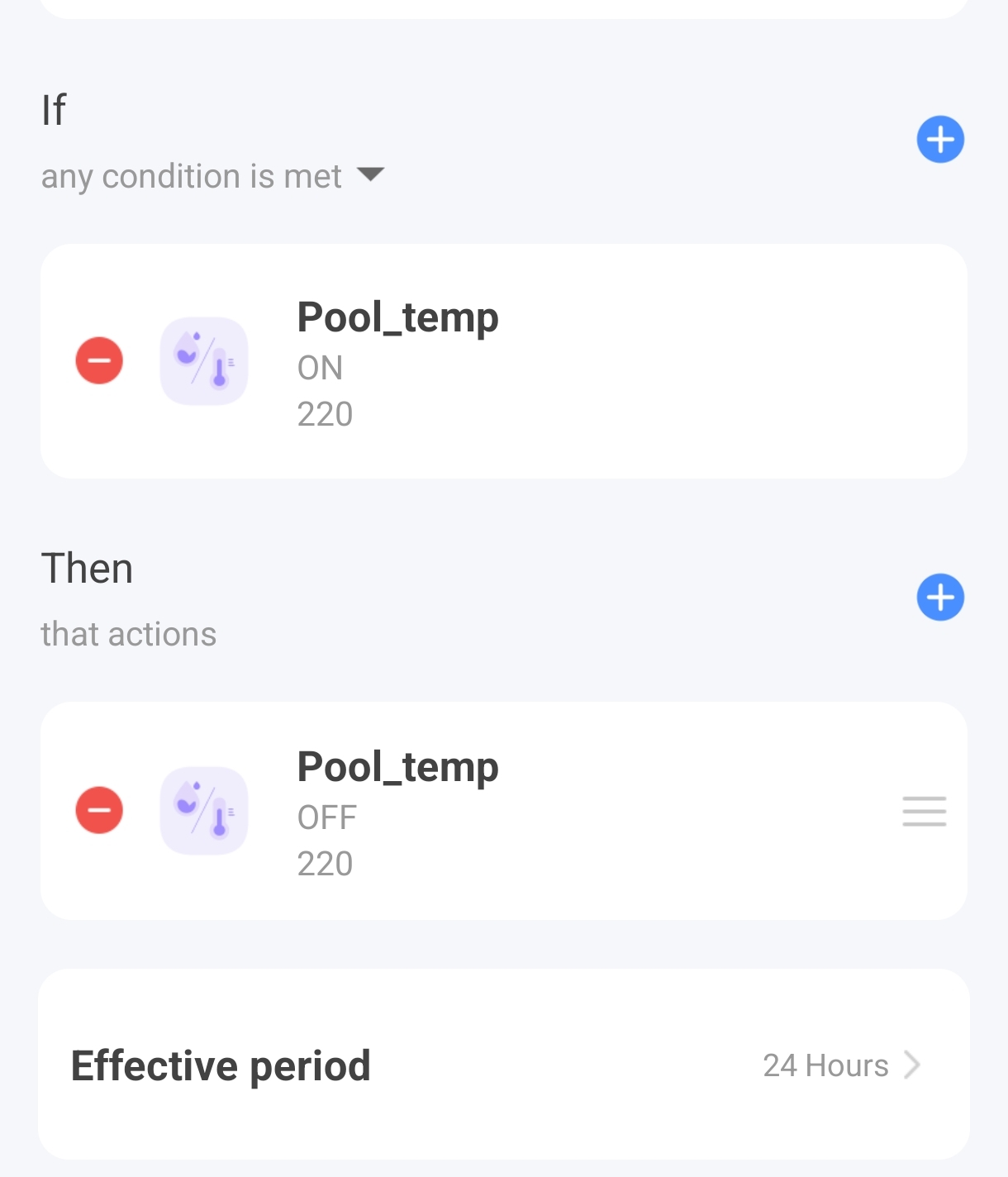

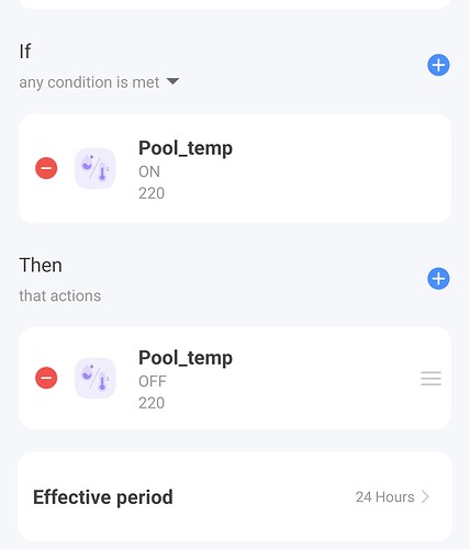

Really? I just did a test run because I’ve been using it for a while now to turn off after a certain amount of time (delay in scenes).
Yes really- I’m not talking about delays. It will allow for some devices eg 4CH switches, TH switches but not for simple switch devices wi-fi or Zigbee. See screenshot video:
