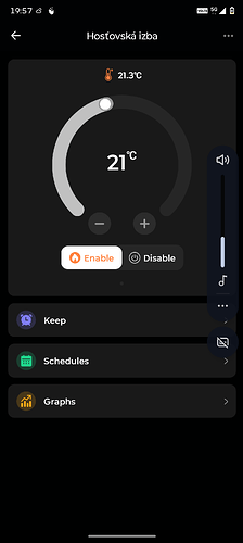

Walt , i am create today for you screenshot
temp. sensor is a sensor that measures the temperature in the room
actuator of the device that is to turn on when it drops below the desired temperature
I give temp accuracy 0.5 degrees to avoid too much cooling
That’s the whole setup of the thermo plugin. Now we’ll show a scene that turns off the heating when it exceeds the floor temperature.

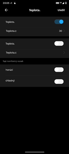

9
create an automatic scene. put a thermometer in the floor in the if item. on it set if the temperature is greater than, for example, 30 degrees

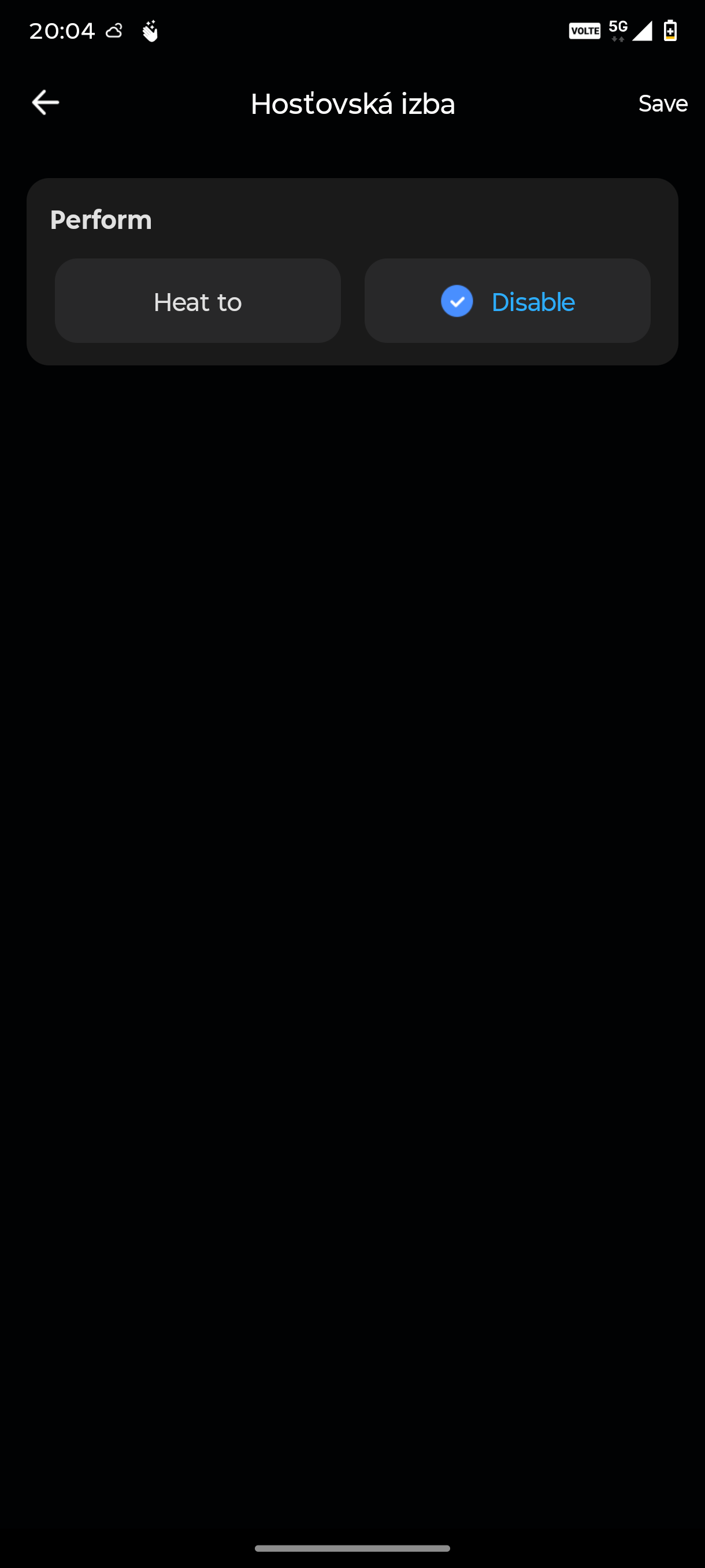

then insert the relay that controls the heating and disable it. then add the thermostat for the room that the heating is related to and disable it.
Then you need to make a scene that will trigger the thermostat in the room if the floor temperature drops below a certain threshold. And enable heating.
