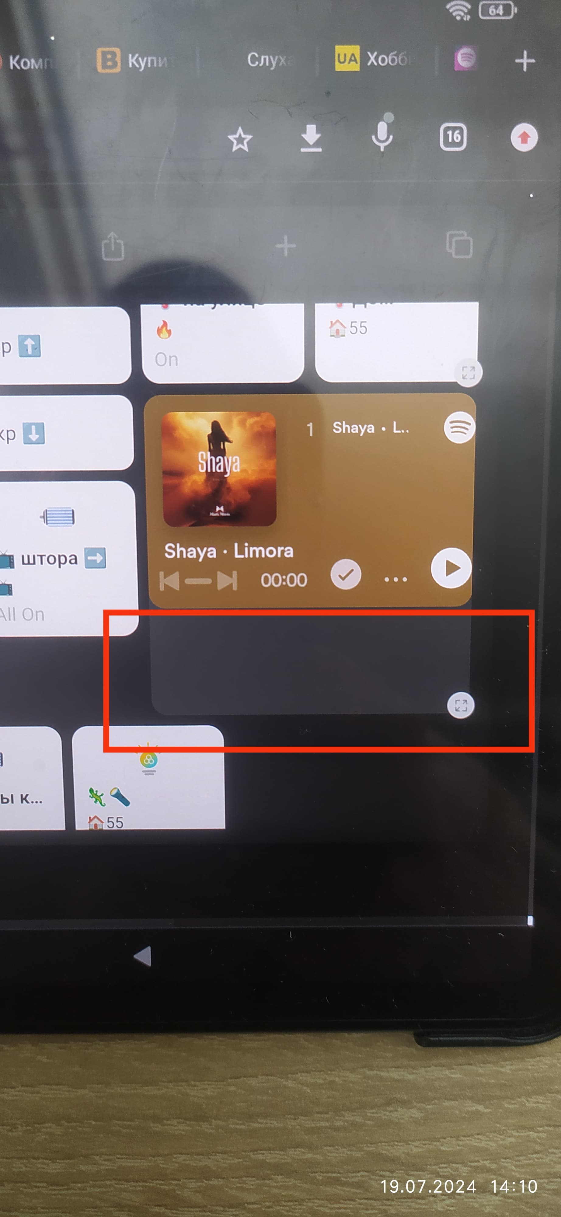

please tell me why it might be displayed this way and not as it should be
hi, what’s your eWeLink CAST app version? have you tried to use a web browser to see if the content display?
and seems you are in system’s dark mode or high contrast mode, have you tried to disable it?
Exiting dark mode did not solve the problem. I pasted the link into the search bar of my browser and this is what I get. Version 2.1.1

I’ve just test the youtube and spotify and the iframe code works.
can you check if your code works on the CAST website:
https://cast.ewelink.cc/
no, it does not work.
hi, the iframe tiles limit is 5, do you create more than 5? or just the 2 shows in the pic and they don’t work?

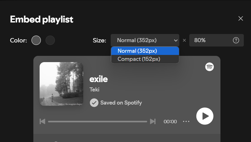

for spotify, please adjust the percentage or select Compact
or just remove the % in the width param filed.
Why there are so many \ and | in your embedding code?
Please try to move all of them and have a try, it should be work then.
Thanks for the help. Everything worked out. Spotify works, but YouTube is not interesting to me. But there is a note about the size of the Spotify tiles. Occupies unused, useful space. The following note and wish in general regarding the cast panel. Tiles that do not indicate turning devices on and off (various sensors and scenarios, also dual r3) are the same color as the controlled devices in the turned on state (sockets and switches), which in turn is a little confusing and confusing when I check what is turned on in the house. Also, motion and presence sensors are designated the same way, by a moving person. They need to be separated by detection. In general, motion and presence sensors need to be highlighted somehow when detecting a person or movement. As an option, you can make some kind of contrasting contour illumination of the tiles so that it catches the eye, and if it also blinks and pulsates, then it will be even better!!!

for now we only provide 2 sizes tiles and may not compatible will all content from various platform, for Spotify, if you use the single song code, it will fill the frame, but the playlist and artist do not, and seems Spotify provides fixed size only, changing the width and height does not work.
